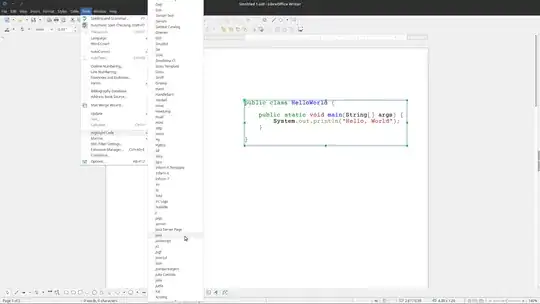

UPDATE 2: LibreOffice Extension
I have published my previous macro script as an extension: Code Highlighter which is available in LibreOffice Extensions store.
1. How to install?
Follow these steps to install the extension:
Step 1: Install libreoffice-script-provider-python:
sudo apt-get install libreoffice-script-provider-python
Step 2: Install pygments for Python 3:
sudo pip3 install pygments
Step 3: Download and add the codehighlighter.oxt extension to Libre Office
2. How to use?
  • Open LibreOffice Writer/Calc/Impress.
  • Insert a Text Box (Insert -> Text Box).
  • Copy and paste any code snippet into that Text Box.
  • Select the Text Box.
  • Highlight by Tools -> Highlight Code -> < Language-Name >
You can assign keyboard shortcuts for frequently used languages. To see how to assign keyboard shortcut, visit the Git Hub page: libreoffice-code-highlighter

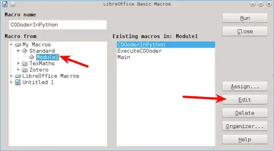

Actually there's a way to bind coloring in a given language to a hot key. Make the following sub and bind it to a hot key:
Go to Tools → Macros → Organaize macros → LibreOffice Basic. Select Module1 and press Edit:
Then copy-paste this code:

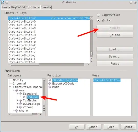

Finally bind that to a hot key:
