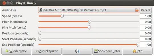

Playitslowly Install playitslowly
There is PlayitSlowly, intended to do this (among others things). You can also save a sound file with altered speed or pitch.
Install via the software center
