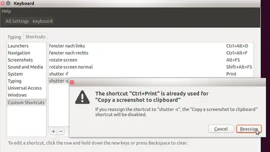

You can change the shortcut in Keyboard settings.
Remove the xfce4-screenshooter ones and create your shutter ones.
mreq
  • 4,932
You can also replace the default screenshoter gnome-screenshot in Ubuntu 14.04 Unity with shutter in the unity-control-center:
use shutter -s to select an area and shutter -f for a full screenshot
