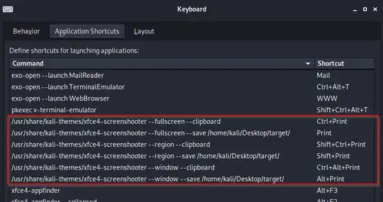

Xfce4-screenshooter
Open Settings Manager -> Keyboard -> Application Shortcuts to edit the default commands for the screenshot tool.
Shortcuts
You can see my settings (on Kali Linux 2021.3 in VirtualBox) in the following screenshot:

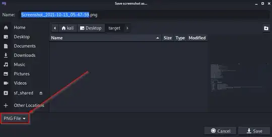

Format
During the "Save screenshot as..." dialog, you can choose the format of the screenshot: PNG, JPG, or BMP:
