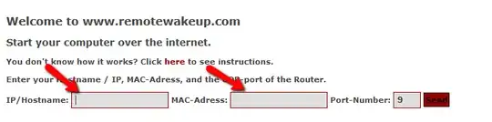

Try Remotewakeup. It allows you to start your computer over the internet.
For complete instructions visit their site
If the system is switched off, make sure power is still getting to the network card. Make sure that the LAN connector light is on.
