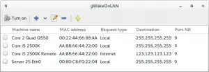

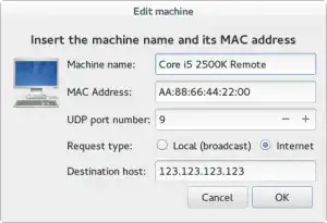

Tools to help set this up, configure and/or use:
gWakeOnLan
Installation: sudo apt-get install gwakeonlan or click this button
Install via the software center
Images from ubuntugeek and that site also has a summary:
Requirements to allow gWakeOnLan to turn on a machine all these requirements must be met. Each machine to turn on must:
  • have an integrated (or PCI/PCIE) Ethernet network card.
  • have the network cable plugged all the time.
  • have the power cable plugged all the time.
  • support the Wake On LAN with the Magic Packet.
  • have the Wake On LAN enabled in the BIOS.
  • have the Wake On LAN by Magic Packet enabled in the Operating System.
  • be powered off from the Operating System.
If one or more of these requirements is not met all the time, the Wake On LAN will not work.
