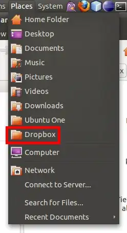

After you have done this you will notice that your Dropbox folder (if you are using the Ambiance theme) will look like this:
Icon Dropbox/Public
And after you bookmarked it by dragging it to your sidebar in nautilus it will appear in your places menu like this:
If this is not the case try refreshing your window by pressing Ctrl+R or F5, if its still not working at that point check the users-dirs.dirs file for any mistakes you could have made.
