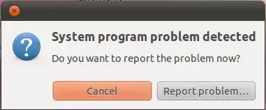

I have multiple Ubuntu Precise servers and workstations, all of which suffer from the same really infuriating problem: when the "System Problem Detected" dialog comes up due to something or other crashing, clicking "Report Problem" throws an elevation dialog... which, unfortunately, doesn't work.
I'm assuming this means that the elevation dialog is looking for a root password - for which there is none - rather than looking for my own password to use with sudo (and, yes, my account is a member of the sudo group, and normal gksudo prompts work just fine).
Does anybody know what's up with this? I'd really LIKE to be able to submit problem reports when things crash. It irritates me to no end that I end up having to just click "close" like some kind of scrub who doesn't care about reporting bugs. >=[

You may be often receiving error messages like the one below, caused by the Ubuntu problem reporting service, apport:
This does not necessarily mean that something is wrong with your system; just that a system process has crashed. When a user clicks "Report Problem...", they are faced with this bug in apport, preventing the actual error report from being sent.
On the other hand, you could receive an error message such as the following
In this type of dialog, the error report service works flawlessly. This, again, reflects bug #1050577 in Ubuntu, which causes the password prompt for the error report in the first type of dialog to hang and prevents the report from being sent.
