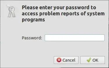

First thing in the morning I started Ubuntu, and the Chrome browser. In the browser I visited a page with a password-field on it. So the password-ring popped up. Then a dialog popped up asking for a password in order to send a bug report about the system. Then the ususal bug-report dialog showed up. (Something about Gud & color)
I am not sure about the exact order of dialogs.
Is the extra question for a password for a bug report normal behaviour?

Sometimes, but not usually.
Reporting Crashes in System Processes
Most of the time when an application crashes or you report a bug manually, you don't have to put in a password for information to be automatically gathered and sent to Launchpad.
However, when a program or service that runs as root crashes, collecting data about that crash requires accessing data that is only accessible as root. In Ubuntu, you can perform actions as root by authenticating with your password, provided that your account has administrative capabilities. (This is facilitated by sudo or one of its graphical frontends, or by PolicyKit.) If your account does not have administrative capabilities, then you will not be prompted to report a crash in a root-owned process until you log in with an account that has administrative capabilities.
When you're logged in as an administrator and you're prompted to report a crash in a root-owned process, you see a password dialog like this:
"Please enter your password to access problem reports of system programs"
This is one of the two situations where you may have to enter a password to report a bug in Ubuntu.
Once you've authenticated, then the crash-reporting process continues the same way as for regular non-root processes.

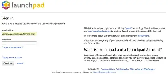

However, if you re-enable bug filing for crashes, or you report a bug by invoking ubuntu-bug manually with a package name or process ID, then you will be given the opportunity to file a bug report. Bug reports in Ubuntu are filed on Launchpad. So once data for the bug are collected and submitted to Launchpad, a Launchpad page to file the bug report with those data automatically attached will appear in a web browser. (Unless your default web browser doesn't work and that's what the bug is about, of course.)
If you're not logged in to Launchpad, then you'll be brought to the Launchpad sign-in page in your web browser, to report the bug. This is the second of the two situations where you may have to enter a password, to report a bug in Ubuntu.
Screenshot showing the Launchpad sign-in page
