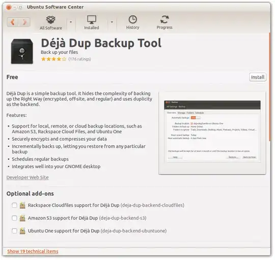

Ubuntu also comes with Deja-Dup by default which supports backing up externally to Ubuntu One, Amazon or even RackSpace. Similar to BackInTime, you can select what to backup, how often and how to restore.
