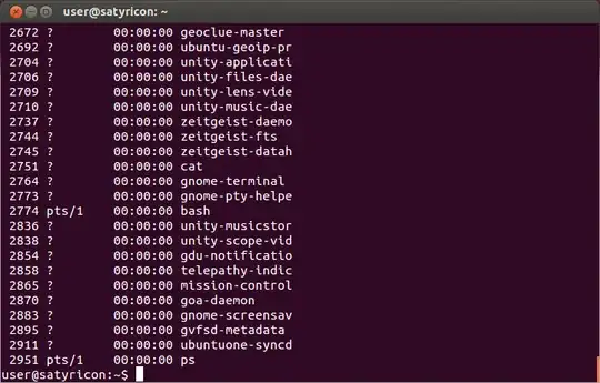

Step 1: Open a terminal and list all running processes with their PID - process identifier number:
ps -e
first list of processes

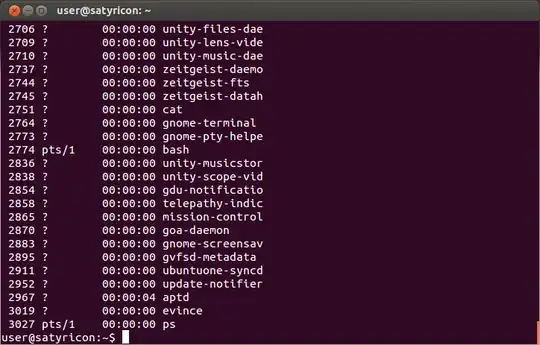

Step 2: Start your program
Step 3: Switch to the terminal and type again:
ps -e
second list of processes
Step 4: Trial and error to find the process of your program.
Ubuntuone-syncd is in both lists with PID 2911. Ps is the process of the ps⁻command in the terminal. There are three possibilities left:update-notifier, aptd and evince.

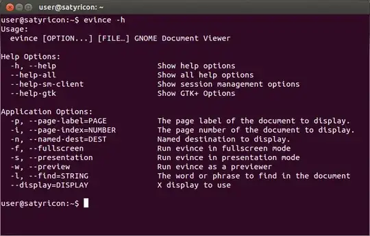

In this case if we type
evince -h
we get:
help option after evince
So evince is the GNOME Document Viewer we were looking for.
