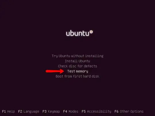

Have you tested your RAM? To test, just boot from the Ubuntu CD/DVD, and Hold down Shift to bring up the GRUB menu. Choose the Test memory option, and let it run for one full pass.
Note: The image below is fro Ubuntu 12.04, and 13.04.
