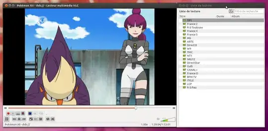

You're requesting to watch TV with VLC - well it is possible. See this answer.

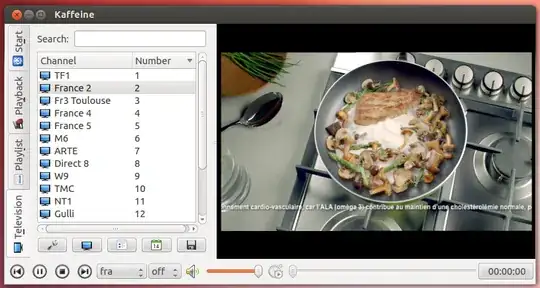

Else some illustrations of the other applications:

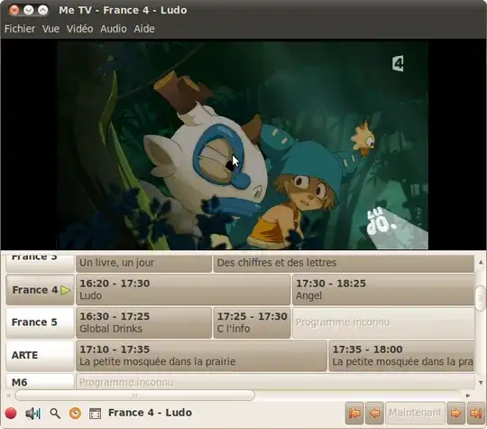

Me TV is a pretty decent under-appreciated application for DVB-* devices.
Has an EPG, even recording facilities. Much, much lighter than MythTV.
To install Me TV in Ubuntu 16.04 and earlier open the terminal and type:
sudo apt install me-tv

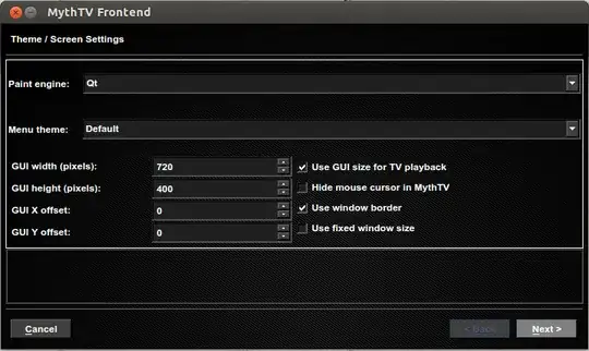

MythTV can also be configured to run in a window. In the MythTV Frontend, go to Setup > Appearance and the first screen should look similar to the screen below. You can set the size of the menu here, and also if you want the playback to use the same size area. Setting the window border option will add or remove the window border, and setting fixed window size will make the windows either resizable or not.
To install MythTV in all currently supported versions of Ubuntu open the terminal and type:
