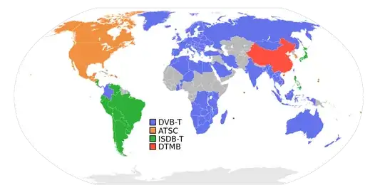

Digital TV
If you are in Europe, you need to use software supporting the DVB standard.
DVB apps (in order of decreasing user friendliness):
  • Kaffeine
  • Totem
  • Me-TV
  • Mythtv
  • Mplayer
If you are in North America, you need to use software supporting the ATSC standard.
Digital TV standards worldwide, as of April 2012
