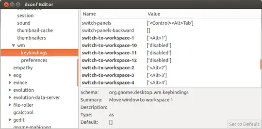

That led me to the dconf-editor utility, where I found the relevant settings:
As you can see, my preferred shortcuts for switching workspaces are Alt1, etc. The square brackets around the Value led me to think that it might allow an array of values, but I although I was able to change the shortcuts via this value, was unable to get more than one to work. It would only use the first which one I defined.

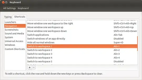

But for anyone who finds this answer while trying to figure out how to set shortcuts for switching workspaces, I should point out that the easiest way to do it is via the GUI. In Unity, bring up the System Settings editor and navigate to Hardware > Keyboard > Shortcuts > Navigation. You'll find instructions at the bottom of the window:
