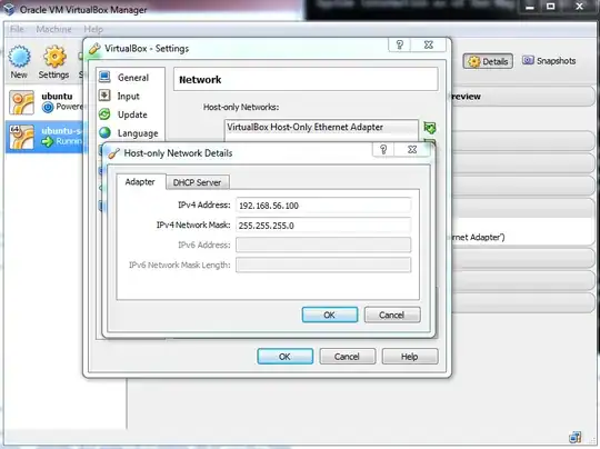

I configure virtual box host-only adapter.
Virtual box host-only adapter configuration

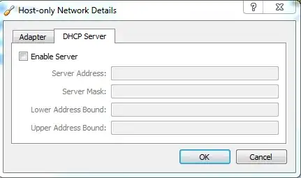

VirtualBox Host-only adapter - DHCP Server disabled
As you can see DHCP Server is disabled and i try both enabled and disabled but problem still there.

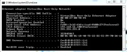

Below is result of
ipconfig /all
from Windows CMD
Windows ipconfig /all Results

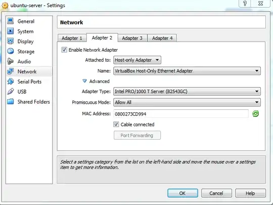

Now My Virtual Machine Network Settings

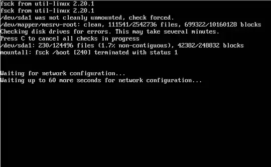

When i run VM the ubuntu force some problem with network configuration as image below
Ubutnu Booting Network configuration problem

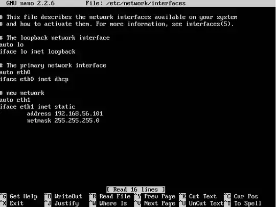

My /etc/network/interfaces file as below:
/etc/network/interfaces content

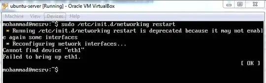

When i restart networking service, show "Cannot find device eth1, Failed to bring up eth1 as below:
restart networking error

VirtualBox network adapter name on guest machine is not fixed all the time, each time you have disable and enable host adapter from VB prefrences, the network device name post-appended number will increase . For example, if you disable and enable network host-only adapter five times, the new network name should be eth4, and if it was eight times , network name will should be eth7 and so on.
if you don't know what is your current network device name, use:
ifconfig -a
it will print all available network adapters ( devices ), find your new name and reconfigure /etc/network/interfaces file with new name.
for DHCP configuration use code below with changing eth5 with your current device name
auto eth5
iface eth5 inet dhcp
And for static ip you can code below: ( you still need to change eth5 with your device name, and also the static ip, no need to change netmask in most situations):
auto eth5
iface eth5 inet static
        address 192.168.56.101
        netmask 255.255.255.0

Faced the same issue after upgrading from Virtualbox 4.x to 5.x (on Debian, but that surely apply to Ubuntu as well). I've left a gateway 0.0.0.0 in the /etc/network/interfaces declaration of eth1 (vboxnet0, host-only), which was fine for the 4.x, but crashed the service in 5.x with failed to bring up eth1.
Removing the gateway (and broadcast and network) of eth1 declaration did the trick.
Note that you may have fixed rules in /etc/udev/rules.d/70-persistent-net.rules that you may want to delete/update.
