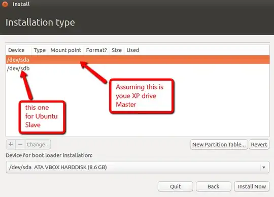

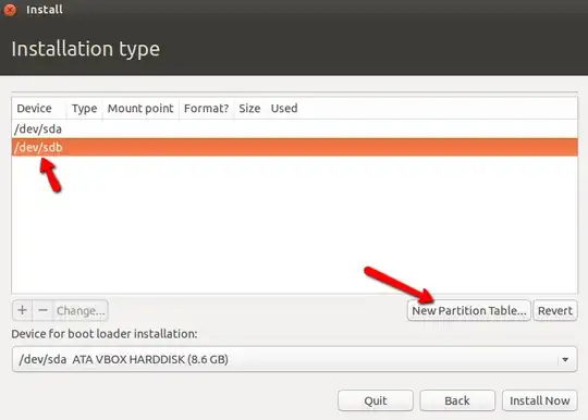

Keep in mind that Ubuntu will not list your drives as C: D: etc. but will refer to them as /dev/sda, /dev/sdb, etc.
Please make a backup of your important data to be able to restore them if anything fails by accident

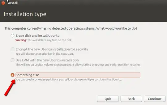

Boot the CD, and start the installation. Once you get to the installation screen, choose Something else

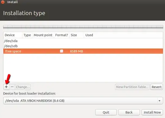

Choose the second Drive

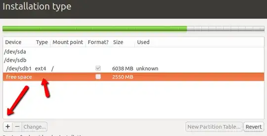

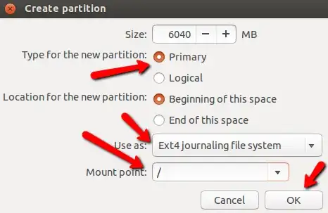

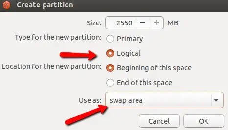

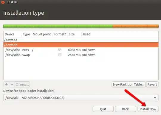

After you choose it, click on Create new partition table, and just follow the rest of the steps, as shown in the images.
