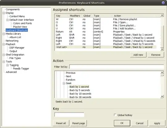

It looks like you have mplayer installed already. If you don't mind using that, you can add controls for seeking forward and back 1 second.
Edit/create either your global- or user- input config file: /etc/mplayer/input.conf or $HOME/.mplayer/input.conf. Then add these lines:
LEFT seek -1
RIGHT seek +1
You'd think that SMPlayer would also honour these controls or have an input.conf file of its own, but as far as I can tell, it does not.

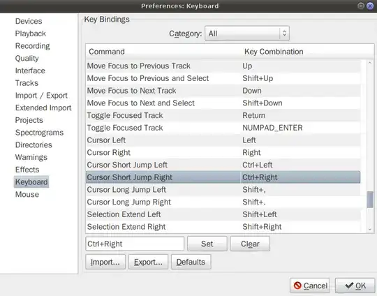

Audacity Install aUDACITY
It not only has by default the left/right keys set for 1-second jump, but this and the other possible jumps are editable. Also, this is an audio editing program, with enhanced control and features needed for such activity as transcription (like removing background noise!)
By default the Space key is not set to pause, but to Stop/Play, so it restarts from initial point. Pause is P. But this is customizable.
I looked up Foobar2000/Wine and it has the option of 1-sec key jump (but the Pause command is not set by default so it too has to be set manually.)

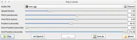

Playitslowly Install playitslowly
This fine software does most you need for transcription of audio files to text. It has the following features:
  • Plays every file gstreamer does (mp3, ogg vorbis, midi, even flv!)
  • Can use alsa and jack
  • Change speed and pitch
  • Loop over certain parts
  • Export to wav
Source: Developer's Blog
The following keyboard shortcuts will let you control playback:
Alt + P - Pause/Play
Alt + E - Rewind to zero
Ctrl + 0 - 9 - Rewind n seconds
