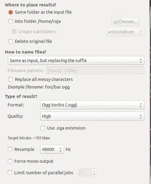

There is one more program named assoundconverter and you can install it with your terminal
sudo apt-get install soundconverter .
from the EDIT -> Preferences options you can customize it as you want. enter image description here
This will convert any format to mp3 and other. hope that helps.
