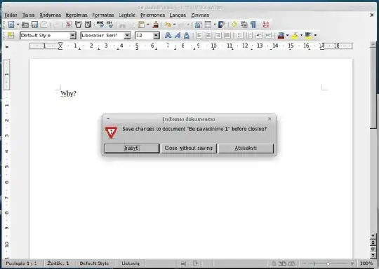

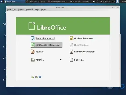

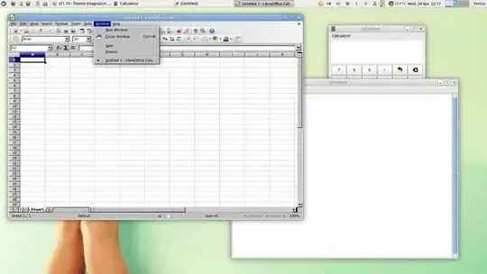

My LibreOffice installation looks like Windows 95. The rest of my Xubuntu looks okay. Why? How can I fix it?
current Libreoffice looks
Click on the image for a full-resolution picture.
On the screenshot Leafpad and Calculator are open for comparison.
Libreoffice Xubuntu dialog window
Libreoffice Xubuntu main screen
