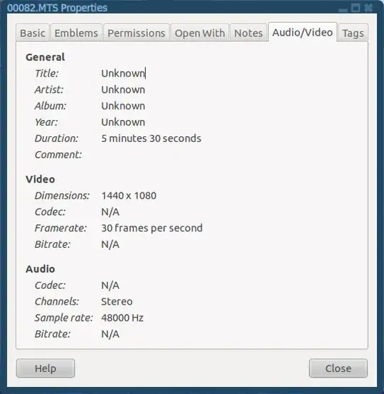

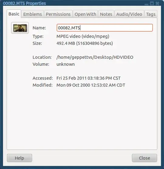

The specs of the video file can be seen in the next screenshots.

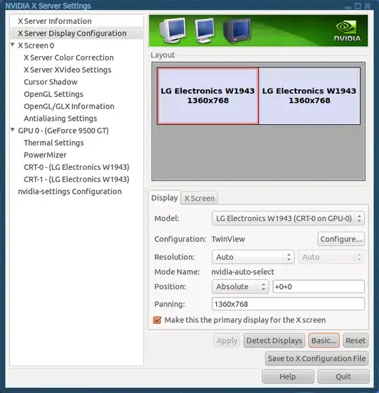

My current monitor config in the next screenshot:
