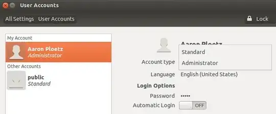

To designate a user as an administrator from the GUI, you can simply open-up that user's properties and select the Account type as the "Administrator" option.
If the user already exists, what effect does selecting this account type have at the system level? (added to sudo group, modification to /etc/passwd or /etc/sudoers...etc)
And how would I accomplish this (designating a user as an "Administrator") from the command line?
