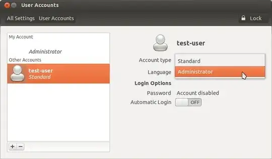

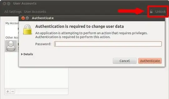

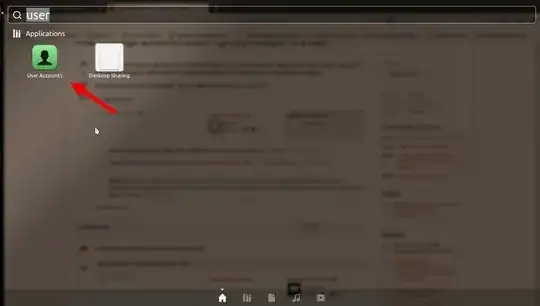

GUI Method
Login from the user who is already administrator, then click on Dash (Ubuntu icon up left) write user and click on User Accounts
Then unlock by clicking the appropriate button and giving the administrator's password.
Last, click on the user you want to promote and change from Standard to Administrator.
