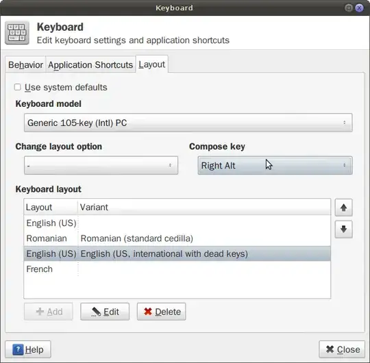

Under Menu > Settings > Keyboard (that is xfce4-keyboard-settings), under the Layout tab, I unchecked Use system defaults, selected the keyboard layout, and then set Alt Gr under Compose key.
keyboard settings dialog
