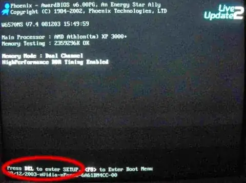

BIOS
...by the use of [Del], [F1], [F2], [F9] or whatever key is indicated at the early stages of the start-up process of the PC,

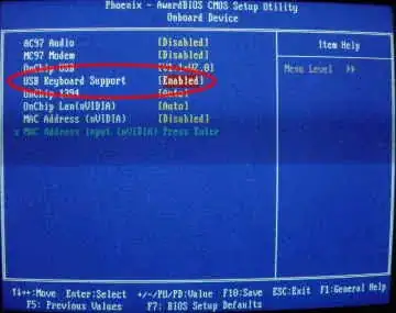

and enable the "USB keyboard support" or "USB legacy support" option that can be found in the BIOS.
Save, exit and reset. If, in spite of the precedent set-up, the BIOS continues refusing to recognise the USB keyboard (e.g. you can't go into the BIOS by pressing the correct key on the USB keyboard) you have a second chance to convince it to.

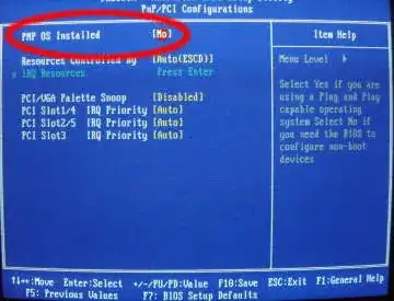

and look at the "PnP mode" option. PnP is the procedure to set-up extension cards and some on-board' chips connected to the PCI bus. As USB controllers in your computer (both on-board as the eventually added expansion cards) are connected to the PCI bus, they have to be set-up by the BIOS to have the USB keyboard working at the early POST phase.
There are two configuration modes available for PnP:
  • the BIOS has to manage the PnP setup;
  • the operating system deals with the PnP setup.
You have to explicitly specify the BIOS has to manage the PnP mode (and not the operating system), to obtain the USB keyboard recognised during this phase.
Verify this and, on change, save, exit the BIOS and reset the PC to control if the USB keyboard is now alive.
