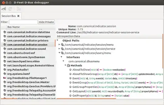

Another good resource for finding out how implemented dbus properties work is experimenting with dbus calls using the rather nice tool d-feet Install d-feet. With this you can inspect or call available dbus properties from the system or the session bus:
