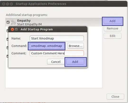

TEST IT
Create a file in your home directory called .xmodmap: touch .xmodmap
Then open the file to edit the contents: gedit .xmodmap
Add these lines:
!Make the F7 key brightness down
keycode  73 = XF86MonBrightnessDown NoSymbol XF86MonBrightnessDown
!Make the F8 key brightness up
keycode  74 = XF86MonBrightnessUp NoSymbol XF86MonBrightnessUp
Save the file then run xmodmap .xmodmap. If the keys now do what you want, continue. If not delete the .xmodmap file from your home.
CONTINUED
Open startup applications from the dash. Click "Add". Put xmodmap .xmodmap in the command field. The other fields are optional, you can leave them blank. Click "Add" again. This makes Xmodmap run at startup.
