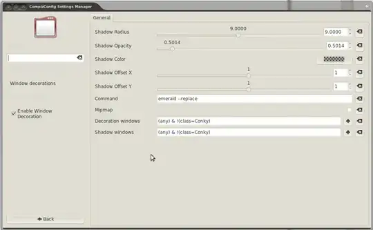

Currently, emerald is being started by compiz, I believe, as I set emerald as my decorator using CompizConfig Settings Manager:
CCSM Screenshot
Is there a better way to do this so that we can ensure that it starts every time?

I think the preferred way to make Compiz use Emerald for the window decorations is to create the file ~/.config/compiz/compiz-manager and add the following line:
USE_EMERALD=yes
The script /usr/bin/compiz-decorator looks for the config file
$XDG_CONFIG_HOME/compiz/compiz-manager
($XDG_CONFIG_HOME is ~/.config by default) for user specific preferences.
So set the command for the Window Decorations module back to /usr/bin/compiz-decorator and create/edit the config file as described above.

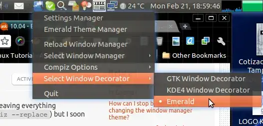

You can use Compiz Fusion Icon which can be easily installed by dropping sudo apt-get install fusion-icon in a terminal. After that, find the fusion-icon in the System Tools menu and you will have several choices in the panel's fusion icon, which includes but not limits to: Select Window Decorator.
Right click the fusion icon and choose your prefered window decorator, window manager and a few other features. Then select "Reload Window Manager" and your monitor or windows may flicker.
Don't worry, it will take just a moment to reload your options and after that you can close the fusion Icon. The options should persist this time.
A screenshot is placed here to illustrate.
Good luck!
