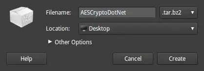

Campression can be done using tar, zip, p7 and even rar in ubuntu. You will need to install rar for rar archiving. Simply right clicking gives you the options for compressing with installed archivers. enter image description here
If you want to use "zip" for .zip extentension you can see manual of zip. The commandline for using tar is:
tar cvzf tarball.tar.gz directory/
