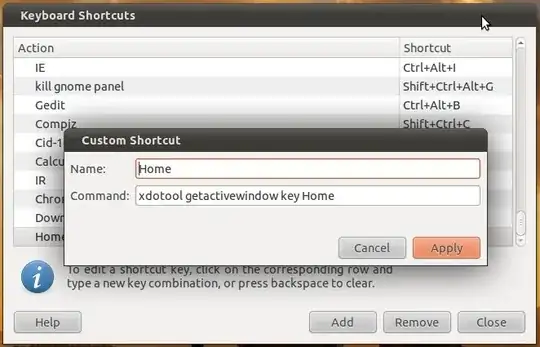

Approach 2. Using a shortcut (combination keys)
  1. Install xdotool
    sudo aptitude install xdotool
  2. Open Gnome Keybindings
    gnome-keybinding-properties
  3. Create the shortcut with this commands:
    xdotool getactivewindow key Home
    xdotool getactivewindow key End
    xdotool getactivewindow key Page_Up
    xdotool getactivewindow key Page_Down
    Example:
Enjoy!
