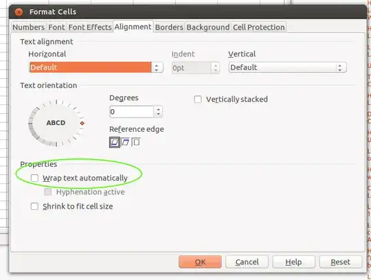

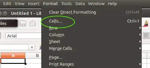

An image is worth a thousand words… so I got 2 thousand words (Plus change) right here:
  1. Select in the Menu: Format → Cells…
  2. Select in the Format Cells window: Alignment Tab
  3. Select Wrap Text Automatically from the Properties section.
    The end result will be something similar to this:
Note that, at least up to LibreOffice 4.0, this option only works on cells that I written in after the option is activated. It will not automatically wrap cells created before.1 See the following image:
The cell above was written before the option was activated. The bottom cell was written after the option was activated.
1 For those wanting to wrap all of their already existing cells in a spreadsheet, simply execute Ctrl+A, following by Ctrl+C, and finally Ctrl+V.

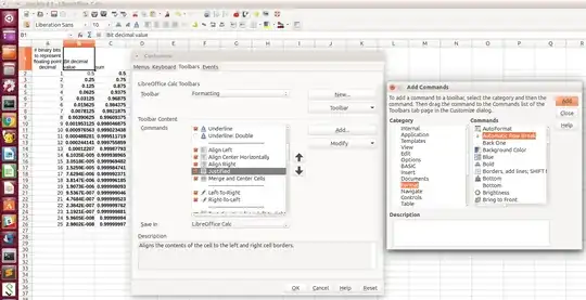

Here's how to add a shortcut icon to toggle "Wrap text automatically" on and off:
Doing it one time through the Format Cells menu is great and all, but I use this operation all the time. Let's add a shortcut button, shall we?
Click View --> Toolbars --> Customize.
In the Toolbar drop down select Formatting. Now in the Toolbar Content section scroll down and click on Justified, since I want to add my cell wrap icon just after that one.
Click Add, then choose Format from the "Category" menu and Automatic Row Break from the "Commands" menu. Here's what those menus look like:
Click Add then Close.
Now click on Modify --> Change Icon... and choose an icon you think looks half-way decent. I chose this one:
when done, click Ok as necessary to exit the menus, then click on View --> Toolbars and ensure the "Formatting" toolbar we just added the icon to is visible. It will have a check mark next to it to indicate it is visible.

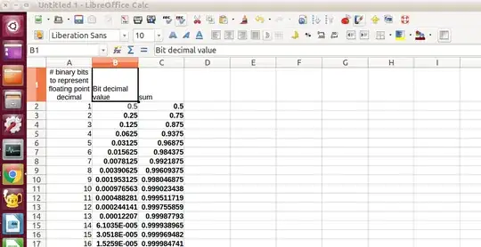

Here's what my icons look like now:
Focus in on this area:
Here's the icon I just added right after the "Justify" icon.
Select a cell and click this icon to toggle "Automatic Row Break" (ie: "Wrap text automatically") on and off, just like you can do in Microsoft Excel!
