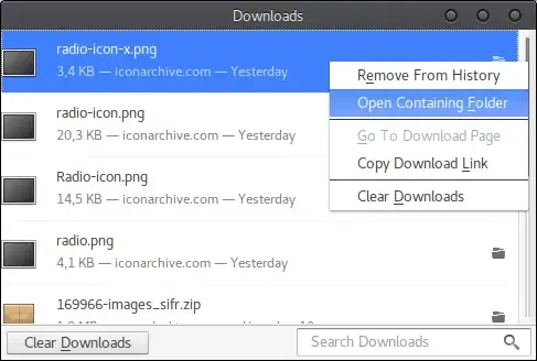

My system default is Nautilus. But when I right-click in Downloads and choose "open containing folder", it opens Thunar and not Nautilus.
Open containing folder
How can I change that?
