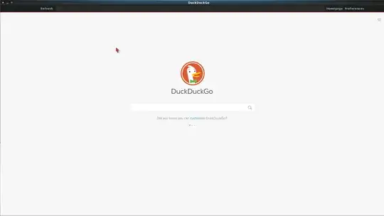

Use Midori's app function. When I make an app this way it is added to launchers.
