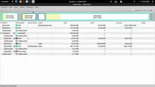

I was fixing my partition with GParted and it seemed to work well.
But, my laptop suddenly ran out of power and I didn't realize it, then it turned off while GParted was still running which was at the part it is copying 2MB per second(on /dev/sda8)
Then, I plugged in battery cable and checked. All system seems normal.
My question is:
  • Since there is no important data in /dev/sda8 , will any problems arise because of what happened? I already checked all the data in /dev/sda8, and there is no corrupted data.

Screenshot of my partition table with GParted + details on un-allocated data:
ubuntu 12.04 LTS 64 bit running gParted with live usb

Theoretical and short answer:
yes, something could have gone wrong (though not very likely in your specific case).
Just to be sure that all is well:
The best thing you can do is running a filesystemcheck on any of the filesystems you have.
(let windows check NTFS, let linux check the ext partitions , etc).
If everything checks out OK and you are not missing any personal/data files, there shouldn't be any reason to worry.
The commandline tool to check the integrity of your linux filesystems is: fsck
The graphical tool for filesystemcheck under ubuntu is: palimpsest
