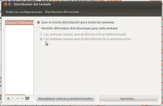

Press the Super key and start typing "keyboard" (for you, it would be "teclado") and open "Keyboard layout" ("Distribución del teclado"). Alternatively, you open "System configuration" ("Configuración del sistema") and select "Keyboard layout".

There you can add another keyboard layout, by clicking on the button with a "+" symbol at the bottom left, check the layout itself by clicking on the little keyboard button, and even change some of the options for your preferred layout (button "Options..." at the bottom right). The latter would let you customize the layout.

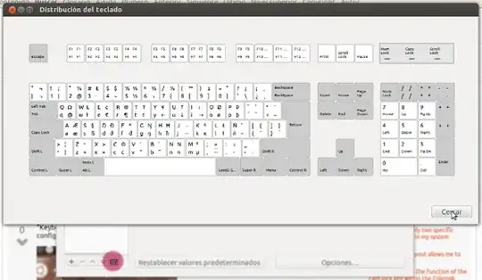

If you only want to know what key combinations are available in you current keyboard layout, click on the little keyboard button (highlighted in pink in the image, below) after you selected the layout.

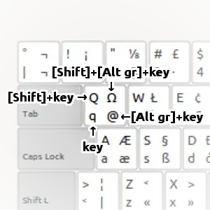

The combinations of keys are as follow:
