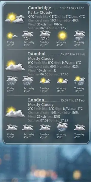

I have created a custom conky showing weather forecasts in 3 cities like this: conky window type override1

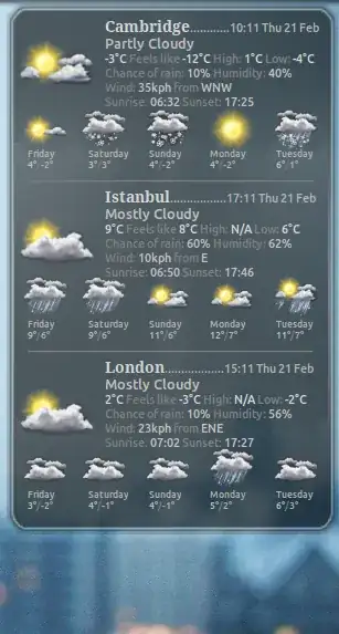

But recently I've begun to see a strange behavior. After a few seconds, a white background a bit larger appears underneath like this: conky window type override2

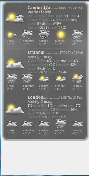

I've attempted to overcome this by trying a number of changes in the configuration file .conkyrc and the only effective one was changing own_window_type value from override to normal. But then I not only have this conky disappear when I choose to minimize all windows, but it also displays a transparent background of the same size like this:
conky window type normal
