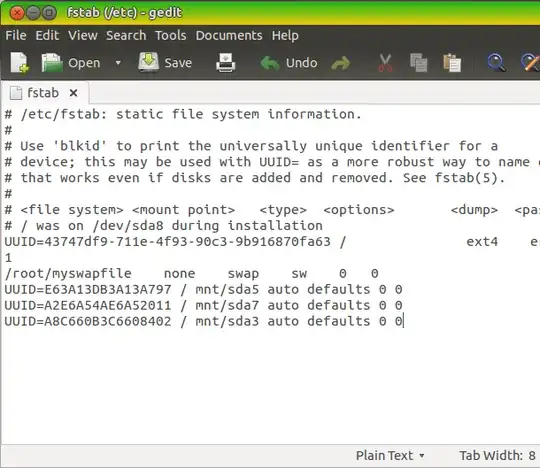

Image of what i edited fstab
The last three lines are the lines I added. According to your first suggestion.

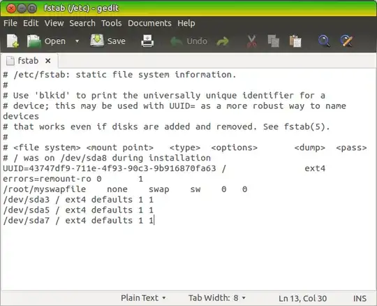

According to your second suggestion.
This is the result of both edits.

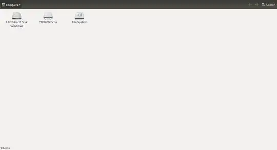

Drives disappeared

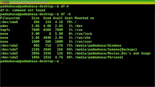

This is the output of df -h
output of df -h

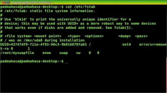

This is the output of cat /etc/fstab output of cat...

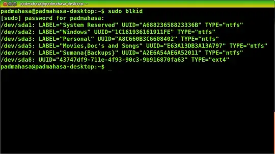

And this is the uuid of all partitions
uuids'.

You really did screw up the mounting. I am surprised you can boot with four devices mounted into the same mount point /. Presumably, it mounts the first (your all important root partiation /dev/sda8) and then fails with mount point not empty when it tries the others (or some other error dependent on the type of file systems involved)

I think you had a spare whitespace between the slash and the mnt/sda. These things matter since you broke the mount point into two.
