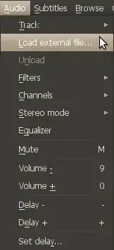

Totem does have an "load external file" option for audio...
It is the second item from the top in the Audio menu (Main or Context)
