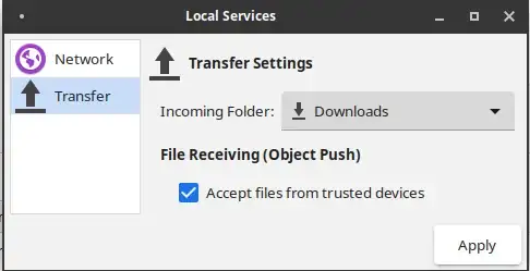

It's a major defect that the BT applet doesn't let you configure where they get saved. Right now it looks like they go into the æther...
[edited] Grrr yes it does...once you find it under "Local Services" FFS, and you still have to enable it to receive. This really ought to work out of the box.
