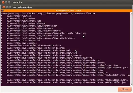

You could also install svnkit, but that comes with a lot of java dependencies. Here is the official screenshot for the package (you can find it in synaptic):
