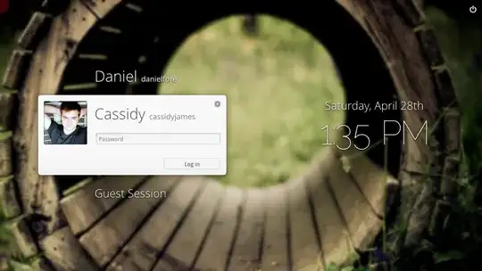

I'm using Ubuntu 12.04, and I'd like to know if I can replace the default login screen (Light-DM) for the one used on ELementary OS (Phantheon Greeter). If possible without installing the rest of the Elementary OS desktop.
Elementary OS Login Screen
