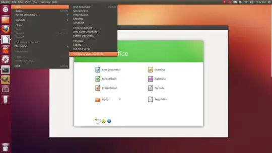

One of the most interesting features of the new LibreOffice 4 is the direct compatibility with Unity's Panel and HUD.
So I've just installed this wonderful new release. Everything works fine... except for that, so as an active user of every existing HUD at Ubuntu, I would like to know how to enable it, as I haven't found any info in LibreOffice's Wiki, in Ask Ubuntu or in the web in general.
Please do NOT post lo-menubar because it just won't work.

Menubar extension is working for me, but not the lo-menubar*.deb - the guts of this package. I don't know how long it would be working. This is very ugly hack and use it at your own risk. Just check it out: http://ubuntuforums.org/showthread.php?p=12515508#post12515508
I'm using ubuntu 12.04, libreoffice 4.0.0 and menubar 0.1.1. I don't know if this is working in 12.10, but really want to know.

How did you install LibreOffice 4.0? Did you use the .deb file? I have heard this does not provide the Ubuntu-centric features, like the menu bar integration. I installed by adding the official LibreOffice ppa and running a dist-upgrade; this seemed to work great! Menu bar is integrated and it replaced the old LibreOffice; even my custom shortcuts on the launcher launched the new vesion.
sudo add-apt-repository ppa:libreoffice/ppa
sudo apt-get update
sudo apt-get dist-upgrade
If you don't have LibreOffice installed for whatever reason, then instead of the last line, type this.
sudo apt-get install libreoffice
