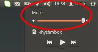

My question is this: is there a way to use it in place of the default audio control shipped with Ubuntu 12.04? I would like to get pavucontrol to appear by clicking on the speaker icon in the Unity top bar.

Unfortunately, this is not possible without editing the source code for the sound indicator.

It is hard coded in the source code, but the change is quite simple.
There is, however, a ready-made package that can be found here:
$ sudo add-apt-repository ppa:mc3man/sound1
$ sudo aptitude update
$ sudo aptitude safe-upgrade
The indicator-sound will be upgraded.
EDIT: According to Launchpad bug #961745, xfce4-mixer was replaced by pavucontrol on Xubuntu since indicator-sound version 0.8.4.1-0ubuntu4
