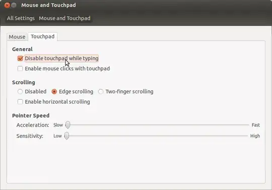

Two ways I know for disable touchpad while typing. First the graphical way. Click on Dash and write : touchpad , then click "mouse and touchpad" to open and tick the box "Disable touchpad while typing"
The second (I think is the same) is the terminal way .. Open a terminal (CTRL+ALT+T) and write
syndaemon -i 2 -d
The number after -i indicates the seconds after the last key pressing for the touchpad to be working again. The -d option is for syndaemon to continue running in background (as daemon).
