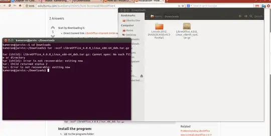

I've tried this guide How do I install LibreOffice 4?
But I get this message
Can someone please explain why this is happening? And can someone tell me how to download it?
You downloaded the .rpm file. .rpm is used by Fedora and Red Hat, but Ubuntu and Debian use .deb.
The correct command to un-tar this file would be:
tar -xvzf LibreOffice_4.0.0_Linux_x86-64_rpm.tar.gz
Did you download using the links from my post? They link to the proper .deb files.
