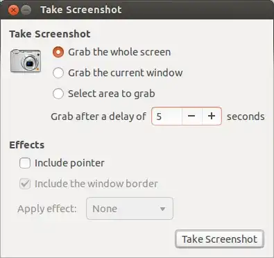

GNOME/Unity in 12.10
The default tool is Screenshot (aka gnome-screenshot if you want to run it from a terminal). So, you would start typing screenshot in Unity's Dash to see it appear for you to click on. You'll then see a small window with several options:
gnome-screenshot
Some options will be exposed depending on what you choose. If you choose to grab the whole screen, the "Include the window border" and "Apply effect" won't be available.
Set things up as you want. A five second delay is a nice starting point to let you bring up the actual screen you wish to capture. To get things going, click "Take Screenshot". Quickly set up what you want and wait.
You'll hear the sound of an (old-fashioned) camera shutter and a new screen will appear.
In it, you will see:
  • a "thumbnail" of the screenshot
  • an option to specify the name and destination for saving the screenshot
  • and the possibility to save it to the clipboard instead if you wish to process the image further.
The default image format is .png, which is, in the opinion of some, a more suitable format than .jpg.
Note that the time delay feature of gnome-screenshot is not available if you choose "Select area to grab".

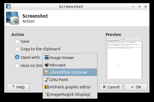

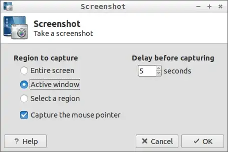

Xubuntu 12.10
The default screenshot tool in Xubuntu 12.10 is Xfce4-screenshooter. It has a GUI that doesn't look too different from that of the GNOME one:
XS-1
As with the GNOME screenshot tool, there are a few options but the delay function is not available with "Select a region".
On clicking OK, another window appears with choices about saving the image to a file, copying it to the clipboard, opening it with programs that can manipulate images (as the dropdown shows), and even uploading it to a specific image-hosting service.
XS-2
If one opts to save the image to disk, a regular "Save as" screen appears allowing you to specify the name, file type, and location of the saved format.
man xfce4-screenshooter has details of the switches available and those could help if a user is interested in modifying the functions of Prnt Scrn and Alt + Prnt Scrn to always use the delay option.
  • Prnt Scrn could be set to xfce4-screenshooter -d 5 -f. Then, any time Prnt Scrn is pressed, xfce4-screenshooter will take a snap of the full screen because of -f after a delay of 5 sec and then prompt you for a filename and location.
  • Alt+Prnt Scrn could be set to xfce4-screenshooter -d 5 -w to grab the active window because of -w.

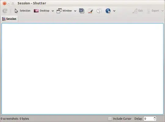

I use a program called Shutter Install shutter. To my knowledge it works on most of the desktop managers - I currently use is in Unity without problems, it works in the current Kubuntu and Mint for me as well.
You can see its got buttons to take screenshots of (in order, buttons from left to right):
  • Selection of the screen
  • One or more of the workspaces/desktops
  • Any window that is open
  • Any selection of a window
  • A single menu or cascading menus from an application
  • Tool tips
  • Websites
Furthermore, at the bottom you can see its also got a delay function. Its got a very nice basic editing tool as well as an app-indicator.
I've been super please with it for a long time.
