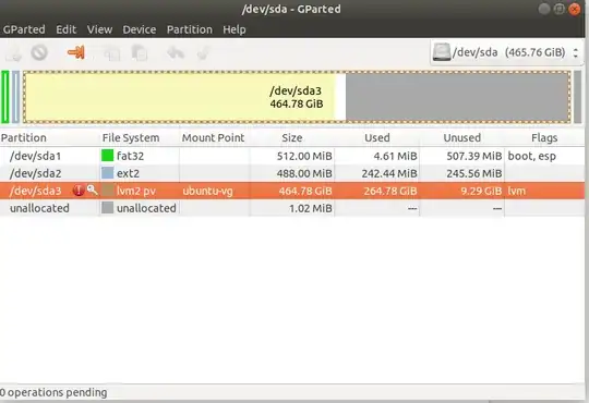

Given the message, I understand that everything worked successfully, but when running lsblock (or GParted), everything remains the same: sda3 was not shrinked.
Important to note that GParted is showing a key icon beside sda3 as if it was mounted, when it is not (as I booted from USB). Running umount confirms that:
GParted screen
ubuntu@ubuntu:~$ sudo umount /dev/sda3
umount: /dev/sda3: not mounted.
Also, if I try to resize sda3 using GParted it will run the same pvresize but will answer NO to the confirmation, so it results is an error.
What Im missing here? Do I have to do anything else? Why isnt GParted allowing me to shrink the partition?

Ok, so after a whole afternoon and part of my evening I found what was going on.
  1. pvresize was changed last year and now it prompts for confirmation when you want to resize a PV to a smaller size than the device it's in
  2. apparently GParted wasn't updated yet, as it will fail when trying to resize a partition as it answers NO to the prompt
  3. as GParted won't run pvresize successfully, it won't calculate blocks and run fdisk after it (just became clear to me after reading this post)
Maybe this bug only happens with newer versions of pvresize (as I'm trying Ubuntu 18.04 it would make sense).
