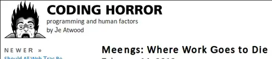

This problem almost fits mine. His font is Helvetica, mine are Cambria/Calibri, his ligatures display as bolded, mine - not at all. So, meetings become meengs, litigation becomes ligaon, etc. Makes for a hard read!

Example from Jeff's Coding Horror, note missing ff in Jeff, or ti in Meetings
Resolution is fairly easy, if you have other Ubuntu computer where all displays properly.
I had Calibri Regular on my system. At work, I noticed, that all sites that were missing ligatures when looked at at home, are displayed properly. I took a look with fc-match what is used there to display Calibri, and sure enough, it was DejaVu Sans. So, at home, I've deleted the Calibri Regular font (DejaVu Sans was second in fall-back stack) and voila:
No missing ligatures
