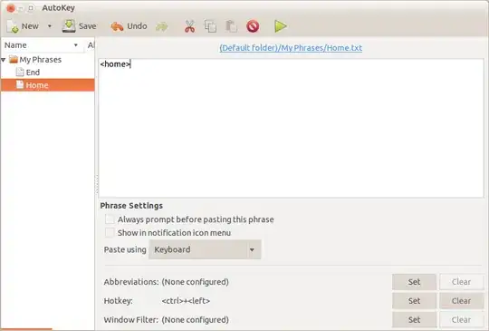

AutoKey can do bindings like this, but it requires running a service in the background (like ahk, but unlike xmodmap).
Configure a "phrase" where the text is <home>, the paste method is Keyboard, and the hotkey is <ctrl>-<left>:
AutoKey GUI
