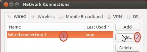

I would recommend configuring your PC properly using Network Manager. I'm assuming you're using DHCP on your network here (most common). Then do this to perform the same as equivalent to the command you were using:
  1. Open Edit connections:
  2. Edit the connection profile you're using.
  3. On the IPv4 Settings tab:
    • Method: Automatic (DHCP) addresses only
      This setting makes it doing a regular DHCP request for IP address configuration of your host, but it will ignore other non-mandatory options like DNS servers suggested.
    • DNS Servers: 8.8.8.8
    • Hit Save
Done.
